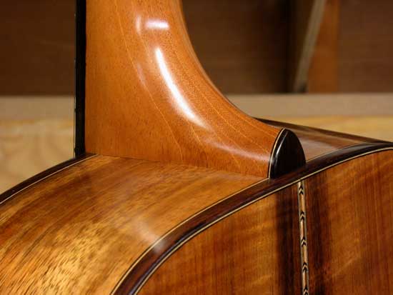

Here's a pic I forgot to post. Another first for me, putting purfling on the heel cap.

I did the glitter testing according (at least as well as I could interpret it) to Alan Carruth. I used the glitter to indicate the resonant frequencies of the top and back. I tuned the back to get it about the same as the top. Glued the plates to the rims and tweaked them again since putting them on the rim changed their frequencies. After the bridge went on, they ended up about a semi-tone apart, with the top lower, close enough for them to work together but not so close as to cause a wolf tone. The top is lower so that as it gets played in, it might end up a little further from the back's frequency, which is better than them ending up closer together over time, or worse yet, the same. The back really moves with the top. That's my simplified take on it, and I'm certainly open to corrections or other interpretations.
